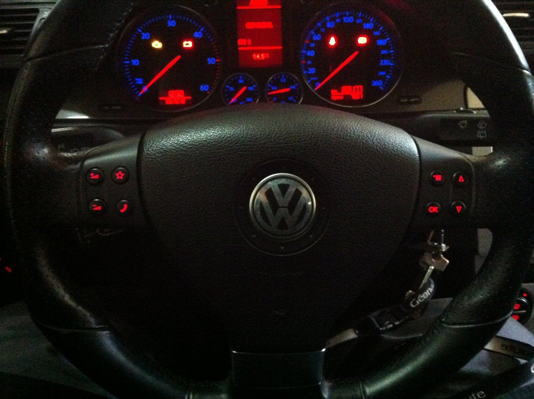

Mk. VII R-Line Steering Wheel with working CCS buttons
